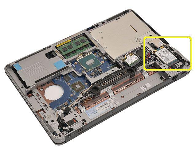

Kjescha Posted October 13, 2017 Share Posted October 13, 2017 Hi, does anyone have a half size pci wifi/bluetooth card which allows AirDrop between hack and iOS devices? I need for my E6440, but I'm not sure which one to take. Unfortunately it has to be half size card, as there is no place for a full size one in the E6440. Thank you in advance Quote Link to comment Share on other sites More sharing options...
Administrators Hervé Posted October 13, 2017 Administrators Share Posted October 13, 2017 That's incorrect, the E6440 actually has 3 x slots for add-on mini-PCIe cards, one of them is full-size (and combo PCIe/BT/mSata). That slot sits on top of a 2nd half-size one and I'd agree that the connector is not easily visible when you remove the cover (because the full size slot is at 90° of the 2nd half-size one). Nevertheless, it's there... I personally use the slot for an mSata SSD... You should consult the E6440 maintenance manual available on Dell's web site. Quote Link to comment Share on other sites More sharing options...
Kjescha Posted October 13, 2017 Author Share Posted October 13, 2017 Damn, forgot to write that I also use a mSata SSD in the full size slot. So still looking for a half size card. Quote Link to comment Share on other sites More sharing options...
Moderators Jake Lo Posted October 13, 2017 Moderators Share Posted October 13, 2017 DW1550 should work for this system Quote Link to comment Share on other sites More sharing options...
Kjescha Posted October 16, 2017 Author Share Posted October 16, 2017 Thanks, I purchased one at eBay. I will report back. Quote Link to comment Share on other sites More sharing options...
Kjescha Posted October 17, 2017 Author Share Posted October 17, 2017 Ok, I got my DW1550 and AirDrop works like a charm. The next step will be to check out handoff. Quote Link to comment Share on other sites More sharing options...
