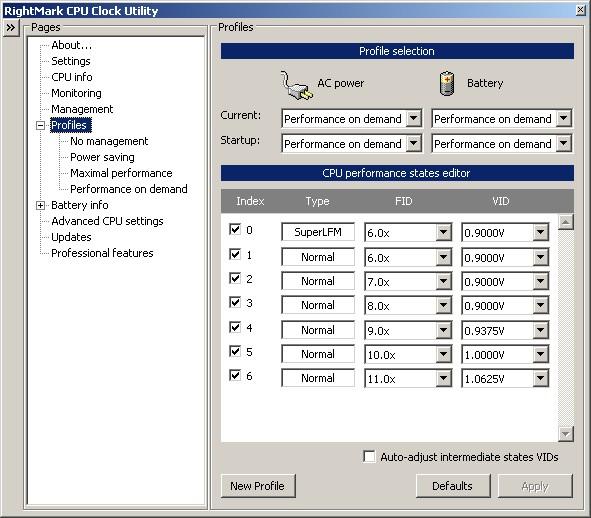

Administrators Hervé Posted September 10, 2012 Administrators Share Posted September 10, 2012 I envy those readings. On my D630 nVidia, CPU T° is in the mid-60s to high-70s range most of the time. It idles around 58°C. I should reactivate my Coolbook license (mislaid many moons ago) and try to undervolt the CPU like I do under Windows. This is the sort of things I run the D630 GMA on and it peaks in the low 60s (idles around 38-39°C): Under Mac OS the CPU voltage is between 1.12V (@600Mhz) and 1.36V (@2.2GHz). Quite a difference... Quote Link to comment Share on other sites More sharing options...
seb43654 Posted September 10, 2012 Share Posted September 10, 2012 I envy those readings. On my D630 nVidia, CPU T° is in the mid-60s to high-70s range most of the time. It idles around 58°C. I should reactivate my Coolbook license (mislaid many moons ago) and try to undervolt the CPU like I do under Windows. This is the sort of things I run the D630 GMA on and it peaks in the low 60s (idles around 38-39°C): Under Mac OS the CPU voltage is between 1.12V (@600Mhz) and 1.36V (@2.2GHz). Quite a difference... Hmm Yes I achieve about the same temps as you, i was just saying that when i ran the fan full for about 10 mins, that the lowest I could get it. There is quite a difference. I am thinking of undervolting - does it damage the cpu or reduce performance? And if I undervolt so my CPU temp lowers, do you think it will affect the GPU temp? I got a big shock when I saw my GPU at 60/70 because my desktop hackintosh only ever gets a maximum of about 45C I assume the laptop is built to withstand it..... Seb Quote Link to comment Share on other sites More sharing options...
Administrators Hervé Posted September 11, 2012 Administrators Share Posted September 11, 2012 Undervolting the CPU will neither damage the CPU, nor lower performances, on the contrary. It simply aims to reduce power consumption and heat for any given performance. It is therefore a conservative/preventive modification that should, at best, maintain CPU life and extend battery usage (it discharges less rapidly due to reduced CPU consumption). It should be without effect on the GPU since it does not alter its voltage or frequency. CPU sitting close/next to GPU, one could argue that it would reduce the surrounding heat and therefore improve GPU temp, but you'd have to see... Space remains quite tight within a laptop casing. Quote Link to comment Share on other sites More sharing options...
