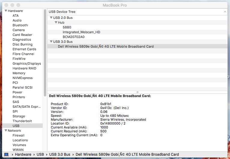

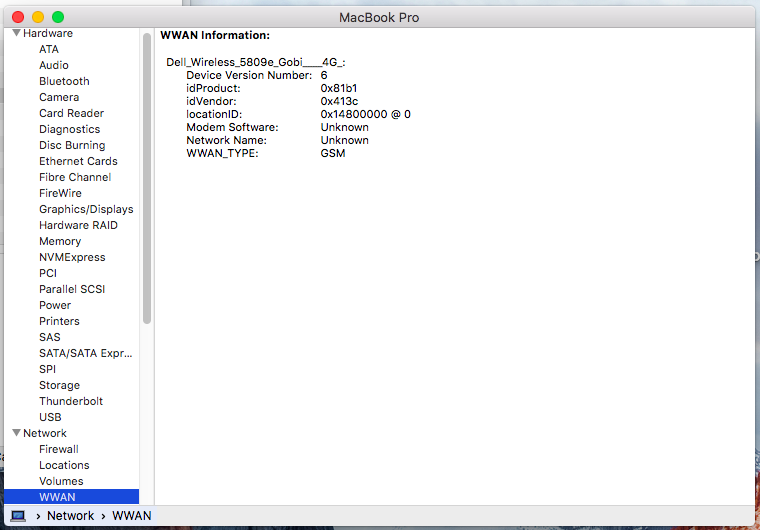

RiaanW12 Posted December 9, 2015 Author Share Posted December 9, 2015 Thank you for the response. I got my WWAN working so that it shows up under my System Report under USB devices and WWAN device using the following method... https://github.com/RehabMan/OS-X-USB-Inject-All Quite an easy fix, just install USBInjectAll.kext and off you go. Now my next step is to get Skvo's Sierra QMI Kext to work as it doesn't work in El Capitan tested now several times, basically to make the modem active to connect in system preferences. Any suggestions? Quote Link to comment Share on other sites More sharing options...
RiaanW12 Posted December 9, 2015 Author Share Posted December 9, 2015 Attached showing the WWAN device in System Report Quote Link to comment Share on other sites More sharing options...

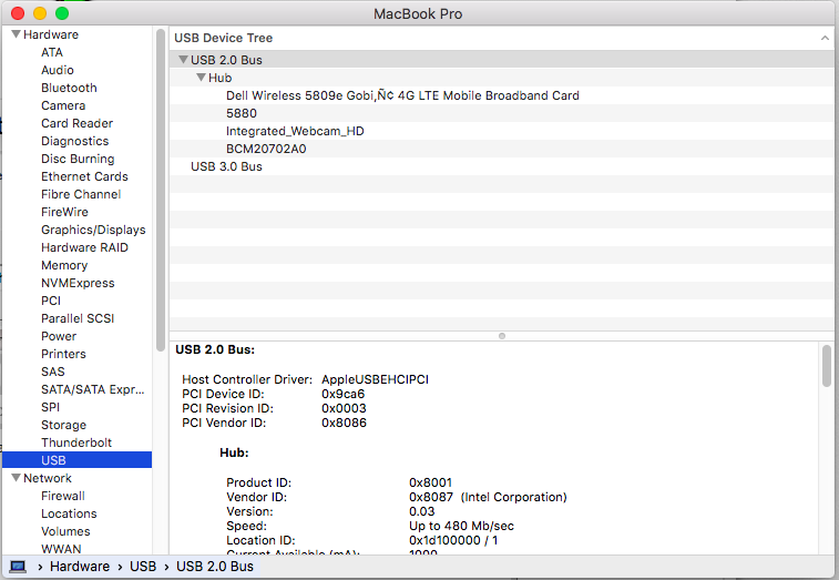

RiaanW12 Posted December 9, 2015 Author Share Posted December 9, 2015 Something I also noticed now... The WWAN now shows up under USB3.0 hub in El Capitan and not under USB Hi-Speed Bus? it was under USB Hi-Speed Bus in Yosemite so not sure if that could make a difference? Quote Link to comment Share on other sites More sharing options...
RiaanW12 Posted December 10, 2015 Author Share Posted December 10, 2015 One step further with hep from Rehabman I was able to move the device under USB2.0 devices. See below. Conclusion seems like the Sierra QMI Kext is definitely then not compatible with El Capitan, 10.11 Quote Link to comment Share on other sites More sharing options...
